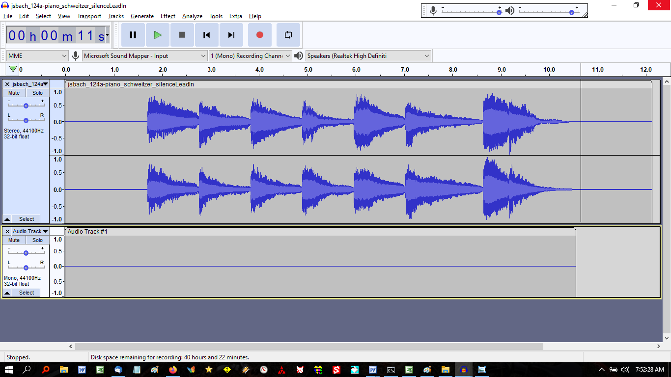

The image above is what I see when I use the (green) Play button to begin playing back the piano track, and then click the (red) Record button and start singing.
Problem: The third track shows that nothing is being recorded.

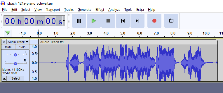

Here I have played back the piano using only the laptop speakers, and recorded my voice using only the laptop microphone.

I have only two options in the device toolbar - “Microphone (Realtek high-definition”, which is/was the default when I started using Audacity, and “Microsoft Sound Mapper”, which I used for the second recording above. This recording, like the first one, plays back my dulcet toned voice (!) with the piano prominent in the background.

Here is my first essay. The piano is the steroe track at top, but my Shift-R recording is flat-lined below; the laptop microphone has not picked up my strong voice.

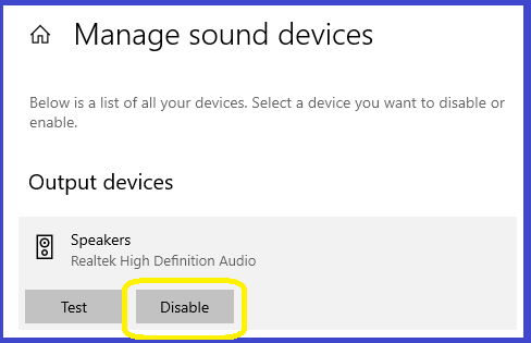

How do I turn off the internal speaker in Windows 10?
How to Disable Laptop Speakers in Windows 10
3 Ways To Disable Laptop Speakers In Windows 10
In Windows10 Control panel I went to “Output Devices”, chose “test” and heard the sound through the laptop speakers; plugged the earbuds jack into the laptop socket, chose “test” and still heard the laptop speakers.
I chose “disable”, withdrew/inserted the earbuds jack, still heard the laptop speakers.
I chose “enable”, withdrew/inserted the earbuds jack, then heard the laptop speakers only when the earbuds jack was plugged in.
Late at night I am not at my best, but the essence is that only after I had run through a disable/enable/disable cycle did the earbuds appear to make the laptop behave as I thought it should.
