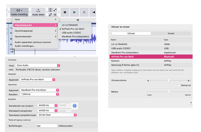

I’ve added screenshots for my settings in Audacity and on my Apple (in 1 image cause I can only upload 1)

If the problem is not a mis-configuration or a result of some software changes - but a problem between Audacity and a Bluetooth device as indicated by @billw58, I’d do the following:
