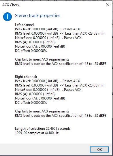

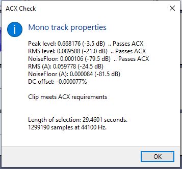

I’m even more confused than before. I get 2 screens when I use ACX check but they contradict each other.

The second screen is typical of what happens when you try to analyze a stereo recording (two blue waves). You get two panels and sometimes two different sets of values. That’s one of many reasons you should be doing post production in mono (one blue wave).
I can’t explain the values in the panels. That can happen when Audacity can’t figure out what you want to measure.
