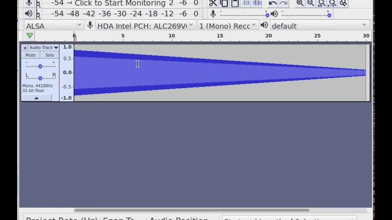

The impression that I get from your first post is that you are trying to do this, but for some reason you are having difficulty doing so:
Yes Steve, that video clip is exactly what I was doing when the problem appeared. Copy, paste past end, move to join (forward? back? to left anyway).
