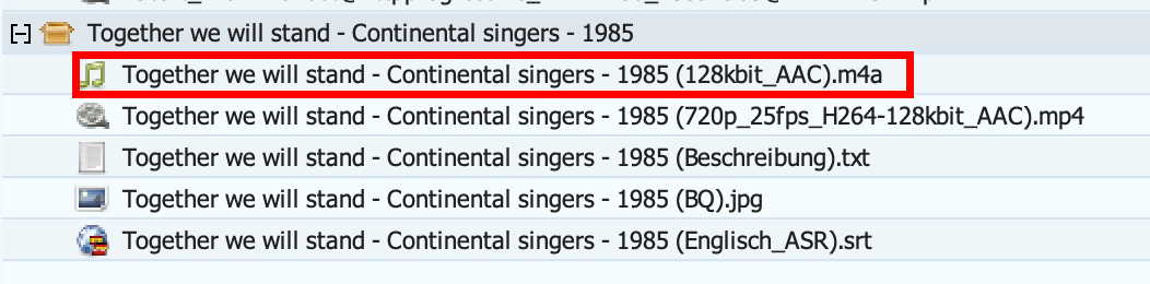

Try to download the movie using JDownloader2. This normally gives you a movie file (.mp4) and a sound file (.m4a). I could open the sound file from within Audacity (menu "File → Open → select the m4a-file).
