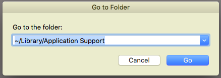

I have downloaded it, dragged it into the audacity file under app support (its alongside ACX Checker, which i have successfully added) but when I go to effects , add etc it does not appear. I dont have a plug in folder under Audacity support, but I have put the RMS download in the same folder as ACX checker, which has attached fine.

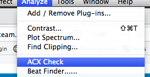

Then, after you get that sorted, use Effect > Add/Remove plugins to make sure audacity can use it.
I’ve checked and its still called RMS-Normalise.ny but it doesnt show up when I go to effects/add plug ins. ( It doesnt show up on the list. )
I dont have a folder called plug ins under audacity it just goes LIBRARY/APP SUPPORT/AUDACITY and then I find a a window with a libs (?) folder and ACX checker and RMS Normalise in it. The ACX Checker shows up fine under when I go EFFECTS/Add plug ins ?
