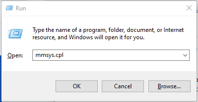

You may be on to something here. Be sure to change not only Audacity’s Project Sample Rate, but the rate for both Playback and Recording Device in the Windows Sound Control Panel:
[Windows-Key]-R, “mmsys.cpl”
Then select your Playback Device:
Properites > Advanced Tab > Default Format
Repeat for both Recording and Playback Devices. If 48000 doesn’t work, try 44100.
