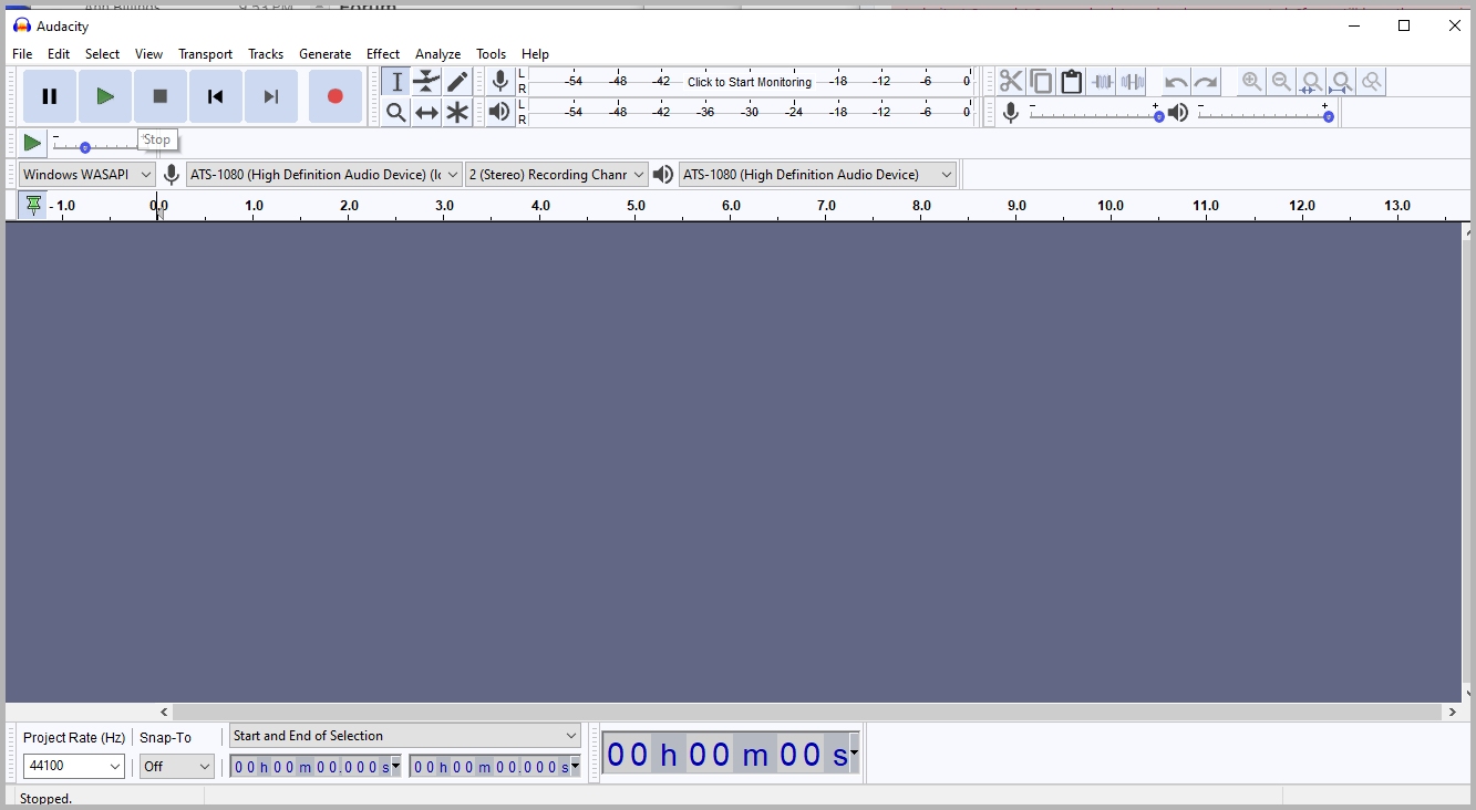

I have the following settings that-in the past-have worked fine:
Windows WASAPI/ATS 1080/2 Stereo/ATS 1080
I have soundbar connected with HDMI cable. Is that the “loopback” device you’re referring to?

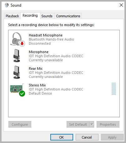

It should say “loopback” in the description for your recording device. I doesn’t completely show-up in your screenshot (too many characters) so I can’t tell, but what I see looks correct.
I’m not sure if every (or any) HDMI device supports loopback recording. (I’ll have to try it on my computer when I get the chance.) You might have to use your built-in soundcard to record internal audio. It might also be blocked if you’re recording from a copy-protected DVD or Blu-Ray.

I have sent attachment with today’s error code.
There is no “Loopback” in the Windows WASAPI box.
It would be in the next box-over for the Recording Device (the microphone icon).
For example, on my computer the playback device says Speakers (2- High Definition Audio Device) and the recording device says Speakers (2- High Definition Audio Device) (loopback).
But your HDMI might not support it (I think it depends on the drivers) so you might have to use your regular soundcard.

For PC internal sound playing on other software apps within PC and being recorded in Audacity… You generally need Sound Mixer enabled in your windows sound settings. and windows 10 or windows 11 settings screens are not goot for setting it.
Go to th “old type” sound settinfg in control panel. Type control panel in search box on task bar and search you will see control panel icon, click it and go to sounds and see your devices all listed. Go to the recording tab and If you dont see sound mixer click to show hidden or disabled. click properties and enable get a green tick as set for default.
Then in Audacity Audio setup Recording device, select sound mixer and set sliders… Keep Transport Options …Enable Audible Input Monitoring OFF to eliminate feedback…
