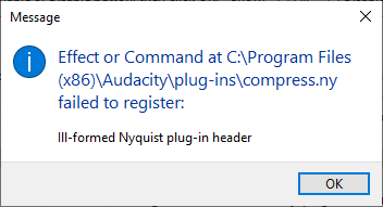

I am trying to install “Chris’s Dynamic Compressor” as described here, here, and can be downloaded here. Following the installation instructions, I copied and pasted the “compress.ny” file into the “C:\Program Files (x86)\Audacity\Plug-Ins” folder, then went to the “Effect” menu, then “Add / Remove Plugins…”, then click on “compress”, then “Enable”, then “OK”. However, I keep getting the same error message: “Effect or Command at C:\Program Files (x86)\Audacity\plug-ins\compress.ny failed to register: Ill-formed Nyquist Plug-in header”
I rebooted my computer, uninstalled audacity, re-downloaded and re-installed it, re-downloaded the plug-in, but all to no avail, I keep getting the same error message. Others must be having the same issue? Any help much appreciated.
The “Ill-formed Nyquist plug-in header” error, says that the plug-in “header” (the top few lines of the plug-in) fails to validate.

You’ve downloaded a web page instead of the plug-in file.
Here is the file that you want:
compress.ny (16.9 KB)
Thank you very much. I can’t believe I made such a simple error. I was supposed to LEFT click “compress.ny” which brings me to the next page where I download the “Raw” file. Instead I was RIGHT clicking “compress.ny” and selecting “save as” which means I was downloading the entire web page! What’s odd is that normally when I download a web page it would have a “.html” extension, not a “.ny” extension. Anyway, thanks again. Hopefully this page will benefit someone else making a similar mistake.
