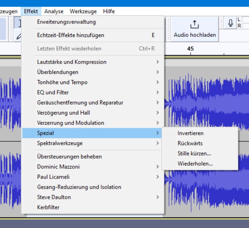

I am not sure that is going to do it. Here is what I get when I change to German:
VocalReduction

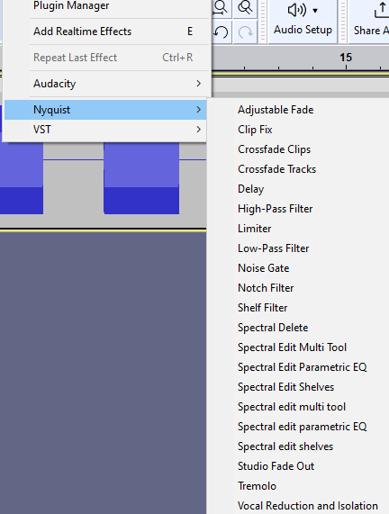

It is possible that the sort shows up differently. This is a Nyquist effect, so under File > Preferences > Effect, set Group by type.
