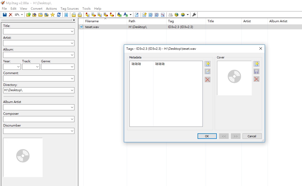

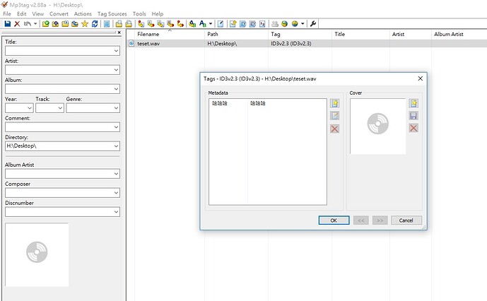

Seems like WAV do not have a common method for meta-tagging. However, according to wikipedia, WAV and AIFF can support ID3 chunks.
So I suppose it depends on how Audacity stores the metadata when we export the file. According to my experiment(open with mp3tag program) on .WAV, it works fine and saying its encoded with ID3v2.3.
