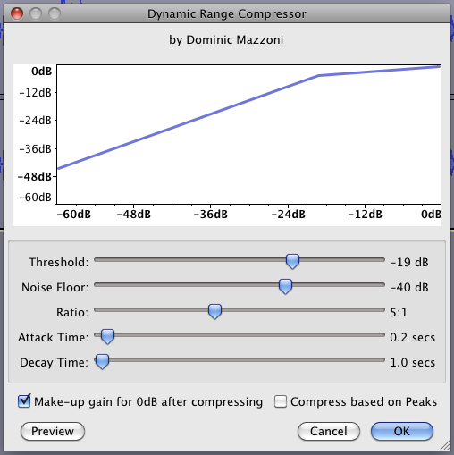

This might also be a good place for Effect > Compressor for the same reasons. The illustration is the settings I used. Koz
Thanks man. I always had trouble knowing which compressor settings to use.

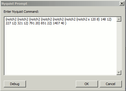

It’s possible to substantially reduce the background hum noise if you paste the code below in Audacity’s “Nyquist Prompt” …
(notch2 (notch2 (notch2 (notch2 (notch2 (notch2 (notch2 s 120 8) 148 12) 227 12) 321 12) 791 20) 851 22) 1407 40 )
Then [optionally] apply Audacity’s noise-reduction …
[ IMO apply the notch filters and noise-reduction before applying any dynamic-range-compression ]
I know where you got 120 from (in the US), where did you get the other numbers – or is this a custom series for that one clip…?

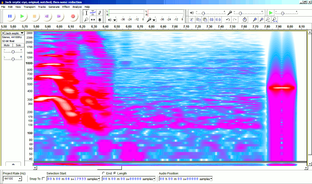

They are the worst offenders on the spectrogram of “silence” on that clip …
septic-eye ''silence'' spectrogram, horizontal lines are hum (mains or HDD or fan).gif

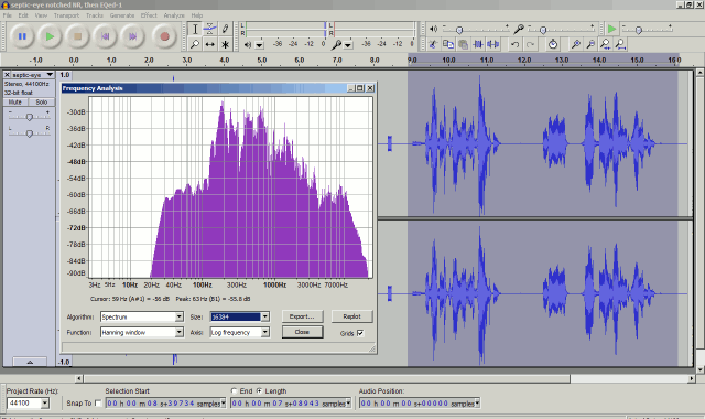

Bass-boost equalization ? …
[ If you want even more treble-boost you’ll need to de-ess , otherwise the sibilance will become too great ]
That should nicely boost the 60Hz hum which has to be in there given the other problems. You didn’t put a notch at 60 (that I can tell). Koz

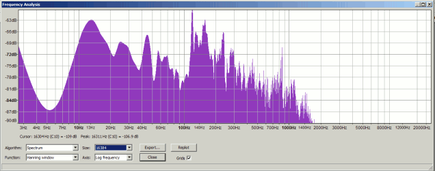

No I didn’t notch 60Hz, but there wasn’t a big peak at 60Hz … Can someone make this clip sound better? - #7 by Trebor
Nor after the bass-boost
The bass-boost does increase rumble a bit, maybe +12dB boost @ 100Hz was a bit too much.
