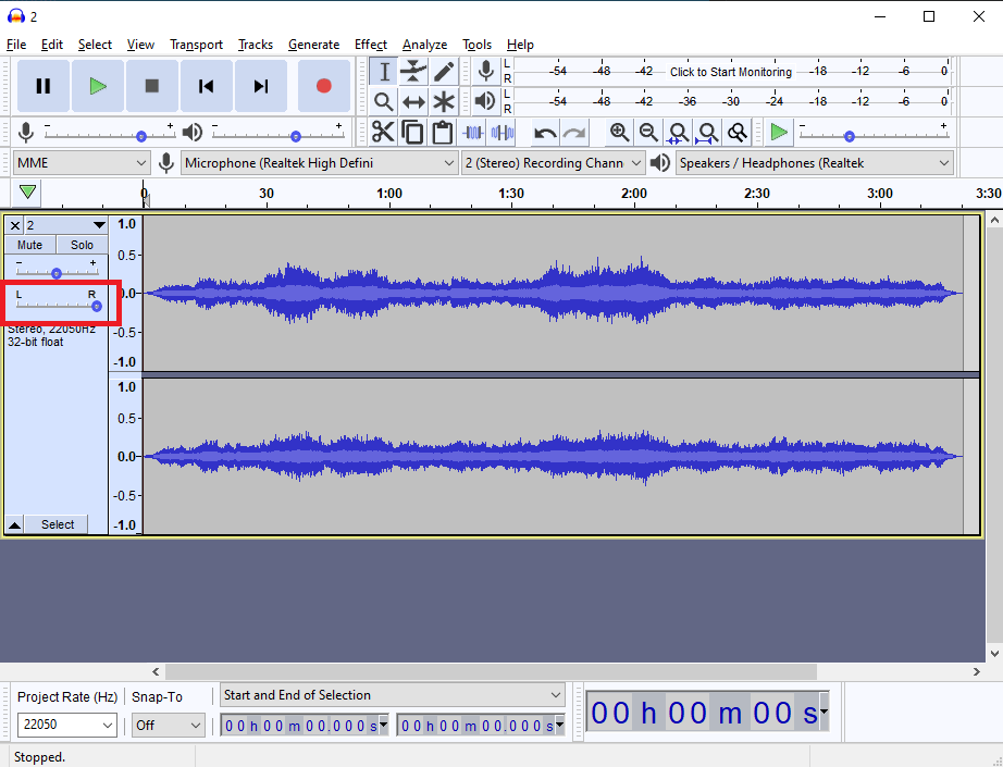

Whats the point in splitting the stereo?. All I did was change the balance with the first option I saw with the slider and exported it shown in this picture. Is there a downside to doing this method?.
