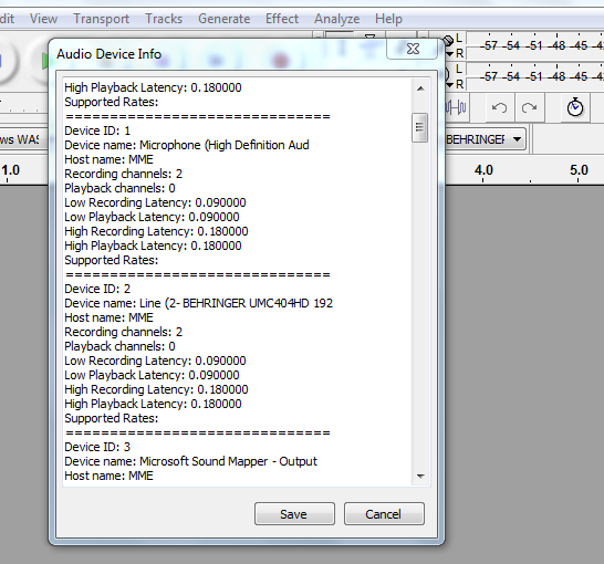

Can only see 2 channels on my Behringer UMC404 Interface
Latest Audacity version. Windows 7. Behringer UMC404.
Don’t know how to tell Audacity that this is a 4 channel interface. Looked all over the place. You’d think this would be a common problem with this interface. Worked fine with my Akia EIE I used to have.

No software came with unit. I had to download a windows driver from the Behringer site but that was it. Trying to get it to work in Audacity specifically. As far as I can tell Audacity is recognizing it as only two channels, not as two stereo channels. Next time I mess with it I’ll record and test exactly WHICH two of the channels it is recording, I suspect its the first two.
