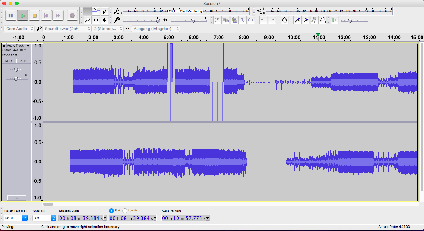

and recovering started properly. Unfortunately the recovered session is corrupted and has multiple errors, including delay between channels, glitches and dropouts. Nevertheless I thank you very much for taking your time.
