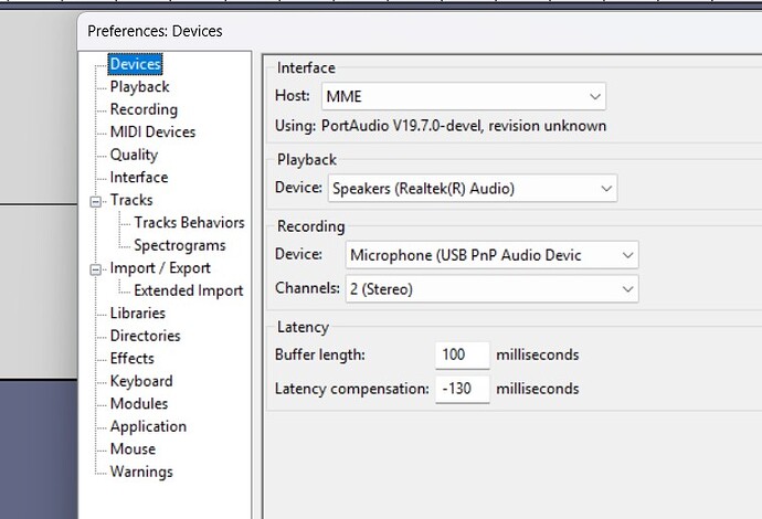

If i try recording in the normal recommended settings, it crashes and I see
“-9999 Unanticipated host error”
This is the actual error:

If I toggle off “Software playthrough” in Transport Options, it doesn’t crash but nothing is recorded either.
I tried updating to Audacity 3.7.0, but then my device vanished completely from Windows Device Manager and doesnt show up in Recording Devices.
