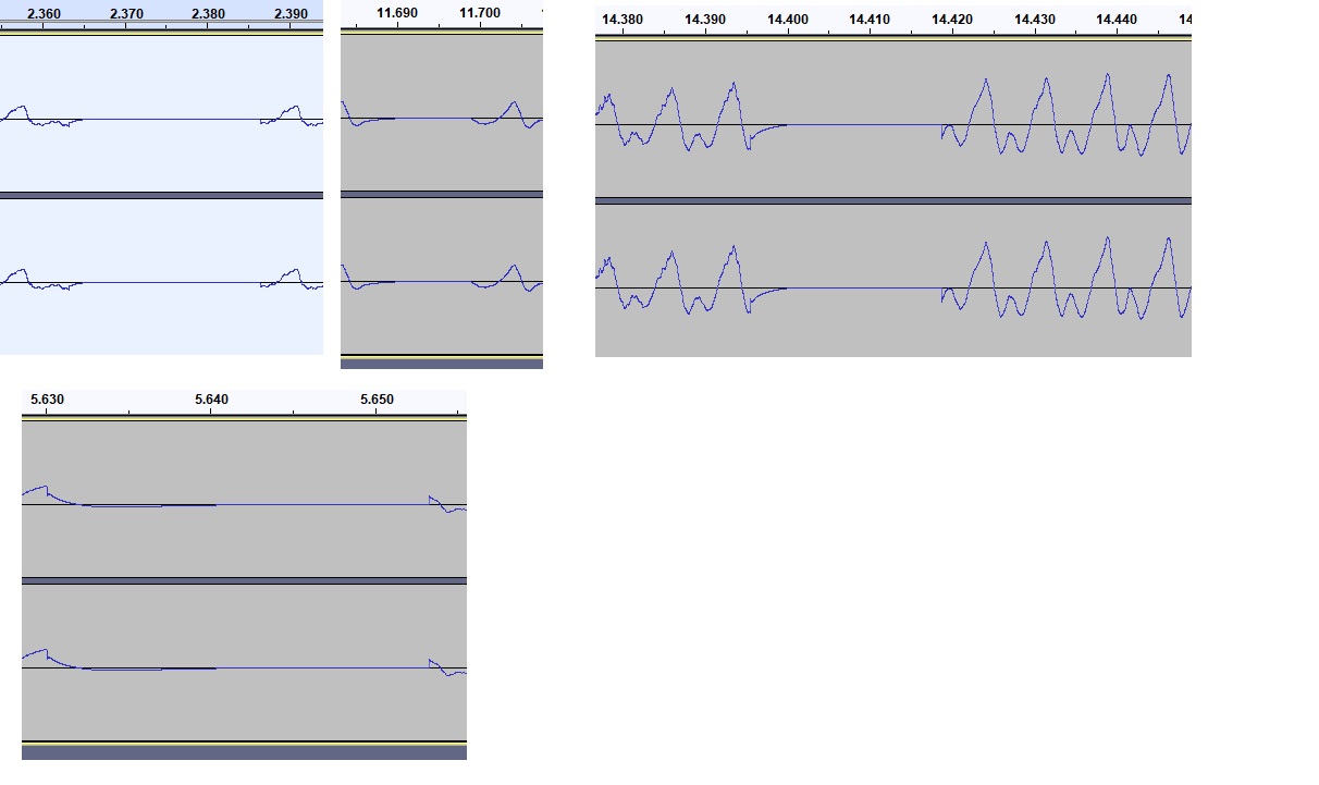

So on the pic you can see couple of types of gaps that my mic is making. I read on the other topics that it can be removed with truncate silence effect and it did kind of work but it also removed silences that were no only in the speech itself but the ones that were just me taking breaths. so it sounded like I was talking non-stop. is there a way it detects these small gaps caused by my mic in the speeches and removes only them? for now I have to manually remove them but it gets so timeconsuming when I have to do 20 mins of audio everyweek.

This is an odd problem. Your show duration is correct, you just have silent bits in place of your voice. What normally happens is the recording briefly drops dead and the recorded show is shorter than the live performance.

In this instance, they’re not dropouts. Audacity is not just missing parts of the performance. Audacity is recording the wrong performance for a while. That’s really odd. None of the usual troubleshooting tricks work.
We usually find classic dropouts by searching for a sudden change between two different sounds (red dot).
It’s a puzzle where the silence is coming from. If a classic USB connection problem is bad enough, Audacity may crash from the data damage. That didn’t happen, either.
