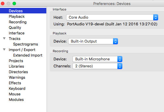

Attach 1
That’s where you set stereo.

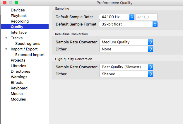

Attach 2
That’s where you set Sample Rate and Bit Depth.
Those are my settings. Audacity will automatically convert to 44100, 16-bit on export unless you stop it.
