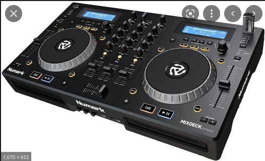

That’s from the top. Do you have one of those “dual-turntable” data controller things with a microphone as part of the mix?

So the real question is how to record the microphone separately. You already have the music part down.

Hi thanks for all the feedback, I have pioneer pro gear, I dj to people on dance floors… I now realise that to do what I want to do which is record a radio show in real time with minimal fuss is to use Ableton for the initial recording then put it into Audacity for further tweaking… thanks for all the comments and help much appreciated…
