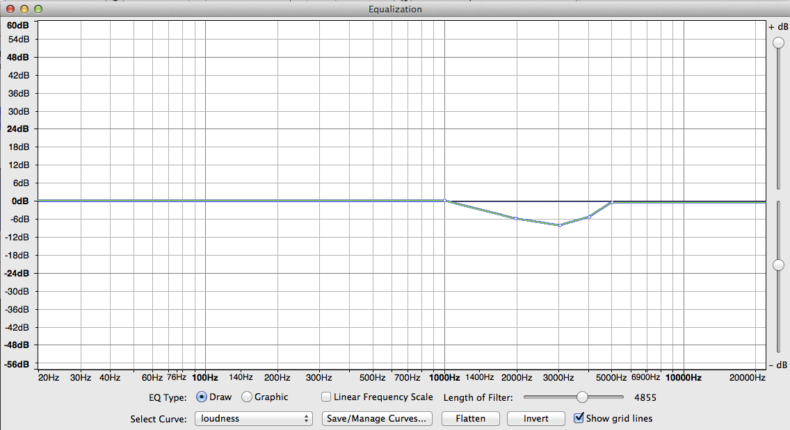

Here’s the Loudness adjustment for Equalization. Just pull it down. I need to remember how to install it. It’s not fun. Are you sure you want it?
Loudness.XML (341 Bytes)
Open your guitar test, or if it’s already open, leave it there.
Effect > Equalization > Save/Manage Curves > Import > Loudness.XML > Open > OK. (If you’re on Windows, the file may or may not have the dot XML on the end.) They did that to make it less confusing.
Back out in the equalization panel, Select Curve… > Scroll down to Loudness > OK.
That should give you a screen that looks like this.
OK.
That’s it. Piece of cake, right? Can you hear the difference? It’s a little more mellow. You can call that effect up any time you want now that it’s installed.
