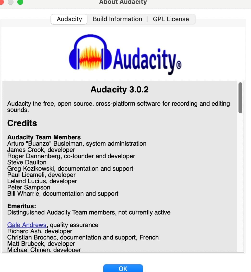

Sorry - I forgot about the check! Yes it is definitely 3.0.2. Well it feels like I have been using it a dozen years, but now I stop and think, yes maybe it is just coming up to 4 years. I have been writing tunes much longer, which is my only and feeble excuse for confusion :frowning:

If you are happy with version 3.0.2, keep using it. I recommend against going back to version 2 at this point - version 2 cannot open your version 3 projects.
Running different 3.x.x versions should not create any problems with the settings.
However, projects created or saved in version 3.7.x can not be opened on older versions. So don’t do anything critical in 3.7.x until you’re sure you like it. If you open a 3.0.2 project in 3.7.x, be sure to use File > Save Project As to save it with a new name.
