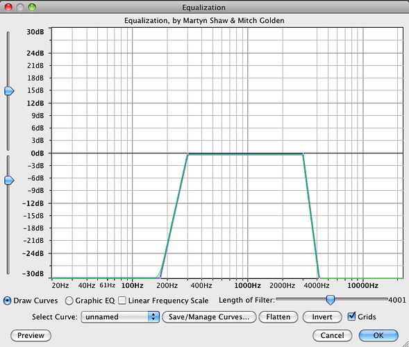

You might also try Effect > Equalization and droop everything above 3KHz and below 300 Hz like the illustration. That’s the telephone filter. That might help a little.

Did you try the equalization filter? Try to replicate the blue wave by clicking and dragging it around. It’s a rubber band. Pay attention to the settings at the bottom, too. Koz
