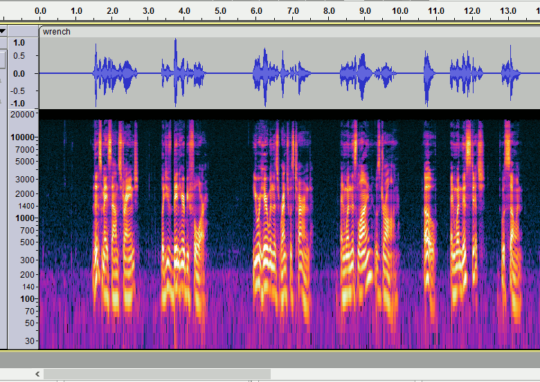

The notches are caused by (destructive) resonance in your booth
notches
They are responsible for the boxy sound.

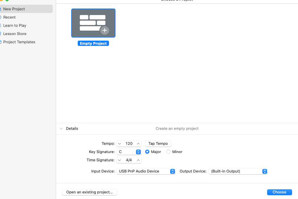

Thanks for the guidance - I’m a neophyte. I open Garageband - here’s the 3 screens that come up, here’s what I click on - or don’t.
Ah, so re Wav… garage band saved the wav file and its was 6.7 MB. Audacity said it wouldn’t accept a file larger than 4MB… so I tried MP3, which saved at 1.3MB. Is there a diff way I can save/upload a wav? Thanks thanks
