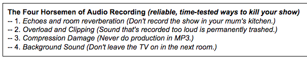

You hit one of the four horsemen. Reliable, time-tested way to kill a show.
#1.

Even expensive, hard to use AI software will have trouble with this. Echoes are your voice or instrument bouncing off walls or ceiling and arriving at the microphone multiple times. You are, in effect, asking the software to remove the voice or instrument from itself.
Post back if you fine a solution.
The right amount of reverberation makes music sound better but usually what sounds good live sounds “wrong” coming from a pair of speakers in a smaller room or from headphones.
With live recordings you get better results with the microphones close to the stage for more direct sound and less reflected sound. And it’s easy to add artificial reverb later.
You can search for a 3rd-party “deverb” or “de-verb” effect. I don’t know how well they work… It not an easy thing to do. And some commercial plug-ins don’t work with Audacity at all.
