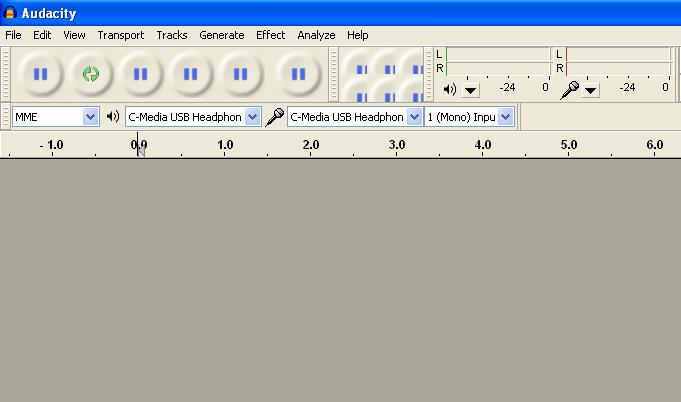

Installed Audacity 2 yesterday on 15 machines. 13 were fine. Two, however show all the buttons as Pause symbol.
It looks like it’s fine recording etc, but it’s not going to help someone who doesn’t know the software.
Am I missing a pre requisite at all? All identical XP SP3 machines.
Attached a screenshot of the buttons.

That looks like the shift key is pressed. The shift key on the computer keyboard isn’t stuck is it?
No, definitely no shift button pressed, that ‘green thing’ just showed up when i hovered over another button. Other machines are identical too. It’s bizarre.

As logging on with a different account “fixes” the problem I suspect that there’s something wrong in the “audacity.cfg” file. audacity.cfg is a per-user “Preferences” file.
Try resetting the preferences for the Admin account using these instructions and see if that fixes it: http://manual.audacityteam.org/man/Preferences#reset

So if you start your .cfg file off as
NewPrefsInitialized=1
then launch Audacity you still see all those Pause buttons?
Do the buttons remain correct after hovering over them? If so does that that only last for that session?
Does the problem correct if you resize the window or use View > Toolbars > Reset Toolbars?

That’s how i left the .cfg file, yeah.
I start it back up and i still see all the Pause buttons.
They don’t necessarily change to the correct symbol and it is also distorted. It doesn’t even last the session!
Resetting the toolbars doesn’t change anything.
