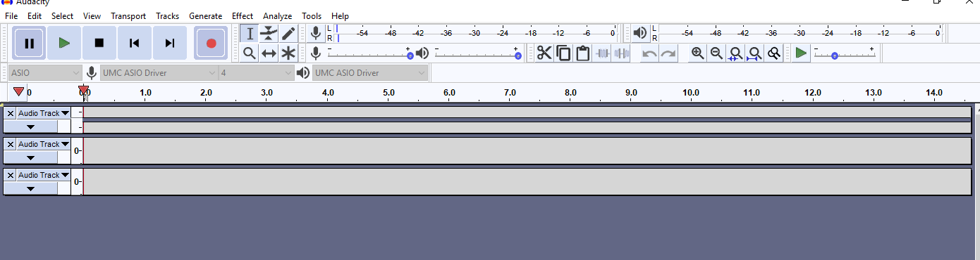

Now that it’s running, though, I do not see ASIO as an option in the Interface Host drop-down in Preferences. Should I? Any idea what I’m missing still?
Thanks,
Paul
