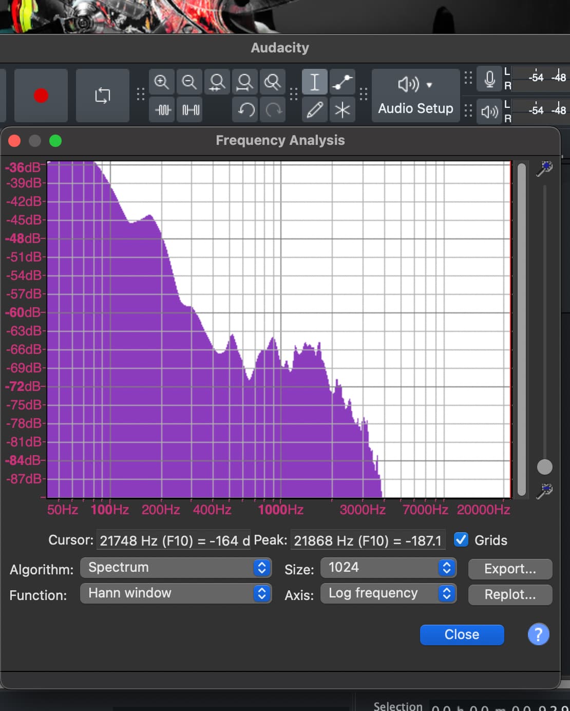

Hello,
I was trying to solve issue #7154 (Black axis label text on grey background is unreadable in Plot Spectrum in Dark Theme on Mac · Issue #7154 · audacity/audacity · GitHub)
I was able to find a temporary fix by altering the unreadable (in dark mode) black text into a shade of pink, which works with all themes present in release-3.7.1 (screenshots attached).
I did this by modifying the code in FreqWindow.cpp(lines 291 and 376) which altered the vertical and horizontal axes text colors by directly writing the color codes.
  S.StartVerticalLay(2);
           //.TickColour( theTheme.Colour( clrGraphLabels ) ) // previous code
           .TickColour( wxColour(200, 50, 120) ) // pink vertical axis text
But I was not able to determine the theme user is in and accordingly use a light and dark text color (if user is in dark and light modes respectively).
Can anyone please suggest how I can solve this issue permanently?

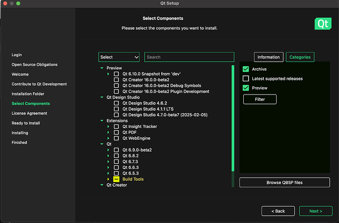

Hi @LWinterberg ,
I’m trying to build Audacity 4 on my machine and followed the Build instructions. I’m facing issues with the Qt installer (ss attached), specifically the mirror link. I’m not able to proceed to the installation of required folders.
I tried to manually download Qt but the build didn’t succeed due to missing file issues in Qt Network auth. I’m from India, if you could guide me to fix the issue, it would be very helpful as I want to work on further issues. Thanks
Maybe your IP range is being blocked by Qt. You may want to try a VPN to get around that.
Ok the VPN method worked. But even in the archive, I’m unable to find versions before Qt 6.5.3
How do I find 6.2.4 which is specifically recommended for AU4?
once you enable the archives, you need to click “filter” again to get the older stuff.
AU4 is up and running, thanks @LWinterberg !!
