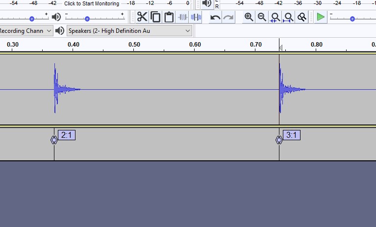

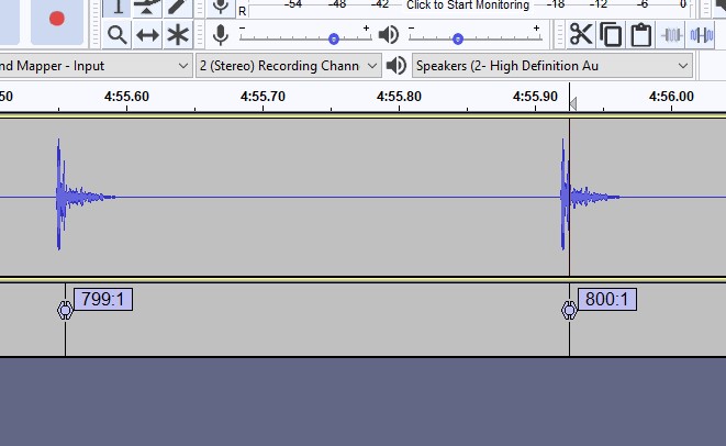

So, this is quite curious. In my Dozen or so years of using Audacity I’ve never had this happen (or I simply didn’t notice it, although I find that a bit hard to believe…). Long story short, I went to make a “click track”/ rhythm track like I do every day, and then I went to make the BPM labels so I can make exact edits, of course, and they’re not lining up for some reason. It’s the oddest thing; the BPM labels start out just a touch ahead of the click lines, then they line up perfectly towards the middle, then they drift to lining up AFTER the click waveform. It’s the darndest thing. I use Audacity for all my pre-pro and rely HEAVILY on this feature, so getting this sorted pronto is an absolute must. I’ve looked in the settings of the Rhythm Track feature and the BPM label maker and everything is zeroed out - No swing or anything.
Can anyone shed some light on this? I am still using a legacy version of Audacity (Version 2.4.2) but that shouldn’t make a difference right?? Been using this exact one for years…

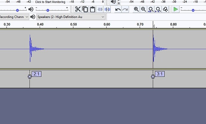

Is there a way for me to attach screen shots here?
Hopefully you can see here. Everything starts out fine, but then drifts off towards the end…
