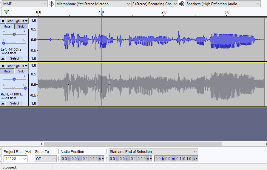

I recently purchased a used Blue Yeti. Every time I have tried to record, I get a high pitched static interference in the background, see attached for example.

I can record stereo audio into Audacity, then choose ‘Split Stereo Track.’ This seems to isolate the high pitch; i can then mute or delete it and all is good. Image below is an example of what post-production looks like with the noise muted.
All of this is to say, I can fix it in post-production, but can never get it to actually record/stream correctly. Did I just buy a busted unit, or is there any hope for further troubleshooting?
