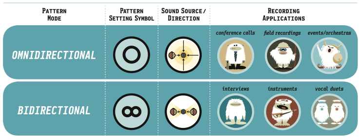

You can also use the pattern publication nobody understands.
If you’re standing at the top of that pattern, you’re in the “sweet spot” for best, loudest sound. If you’re at the exact bottom, you won’t be picked up at all—unless your voice reflects from the walls.
A Yeti has switchable patterns and one of those patterns is Figure-Of-Eight or Bidirectional (from the instructions).
That means it doesn’t pick up sound from the sides, so if you can invent an arrangement where the noisemaker is exactly to the side, the volume should be greatly reduced—unless the noise is reflected from the walls.
Those darn walls cause a lot of problems.
