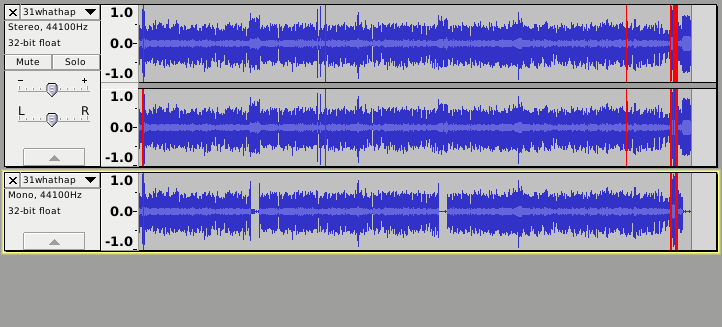

Here we see two versions of your podcast. The upper stereo track is your podcast as downloaded from your site. Below it is the same file, but mixed to mono.
As you can see, there are places in the second version where the show almost disappears. The reason for this is that the left and right channels of the original stereo track are “out of phase”. If we zoom in really close, we can see what that means. The upper (left) channel and the lower (right) channel of the stereo track are virtually identical, but “upside down” from each other (technical terms: “inverted” or “180 degrees out of phase”). When the two channels are added together (“mixed”) to mono, the two waveforms cancel each other out (they sum to zero).
Mixing to mono is what usually happens when listening to a stereo show via a mono playback system. For anyone listening in mono, parts of your show “sum to zero”, meaning that they mix down to silence.

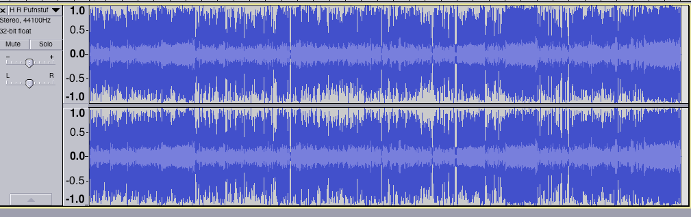

I downloaded the clips off YouTube using ClipGrab. I attached a short snippet of the audio (after I exported it as an MP3) and screenshots of the file in Audacity.

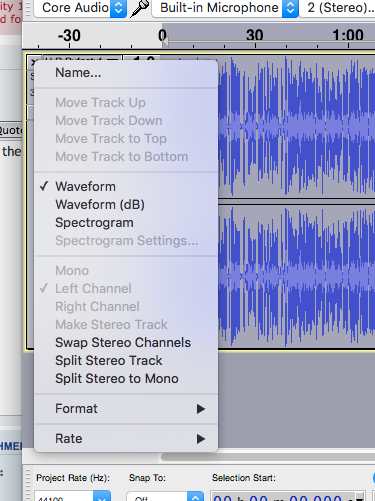

I also took a screenshot of the menu when I click on the filename on the track. I have just noticed that “Left Channel” is checked, but the option is greyed out so I cannot uncheck it. However, in my headphones the audio still does come out of both the right and left.
Is there something I can do, such as “Swap Stereo Channels” or “Split Stereo Track to Mono”? When I tried this second option it creates two files. I can make one the right channel and one the left channel. Would that solve the problem?

If you know, from the extreme zoom method that the left and right sides are out of step with each other, that can be fixed.
Split Stereo Track (but leave them left and right). Select the bottom track by clicking just above MUTE. Effect > Invert. Then Make Stereo Track (from the top track). That’s it. The stereo track is normal now.
You can zoom back in close to see the waves are going the same direction now, and even better don’t vanish any more.

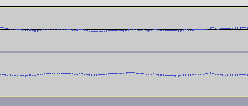

Thank you for all your help. I just wanted to verify a couple things.
  1. In the attached photo is our theme music, which had no issues. I see small variations in the top and bottom stereo tracks. Is this what you are saying I should look for to make sure the audio will still be heard if someone is listening in mono ? I’m just thinking for future YouTube clips I grab, I want to be able to check and see if they will work fine without going through the process of fixing them first.
No. That’s perfectly normal in a stereo show. For example, in an orchestra, the violins will be predominantly on the left, less on the right. So during a violin passage, those two blue waves will be significantly different.
First you should be inspecting a loud passage rather than blue waves that are almost a straight line. I know what I’m looking for and I can’t tell from that illustration. They’re not tall enough.
In the case of a clip likely to vanish, all or most of the blue waves will be mirror images of each other. One goes up and the other goes down. Most observers would call that out of phase or “broken.”
And would it potentially cause any issues if I did it unnecessarily?
Nice try. That little dance, to drop into precise English for a second, reverses in-phase and out-of-phase. If it was broken before, that will fix it. If the clip was healthy, this will break it.
So it pays richly to know ahead of time what you have. Probably the easiest way is Tracks > Stereo Track to Mono. If the clip vanishes or drops significantly, it’s very probably broken. Edit > UNDO.
