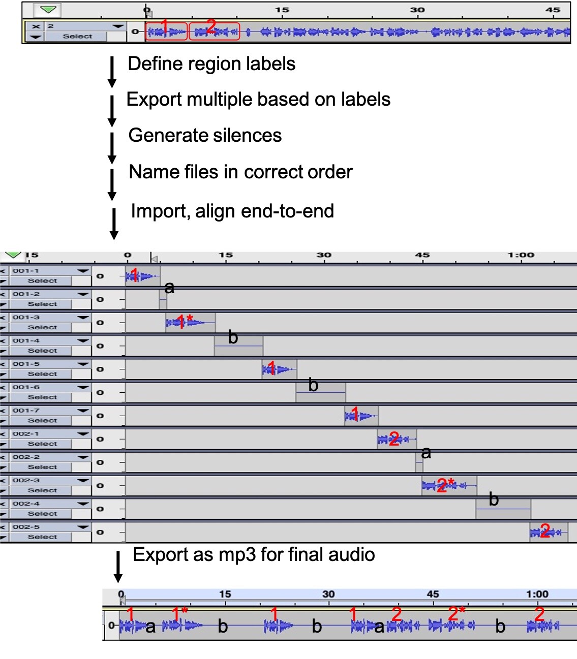

By “rearrange” I mean define small clips, process them, introduce silences, make duplicates,… and then place them together to make a final file. To give a concrete example, the diagram below shows how I currently do this, showing just the first 2 clips (there would be many more following the same pattern).
Here, 1=the first clip, 2=the second clip, and 1*=the first clip slowed down, 2*=the second clip slowed, a=small gap of silence, b=large gap of silence.
My current procedure is:
  1. Define region labels for the small clips
  2. Use Export>Multiple to produce .wav files for each small clip
  3. Generate .wav files containing silence to separate the small clips
  4. Name all the .wav files so they they will order correctly when re-imported into Audacity
  5. Import all .wav files into Audacity, select all and use Tracks>Align End-to-End
  6. Export as mp3 to produce the final audio
I’d appreciate knowing if there’s a better way to do this.
-Tony

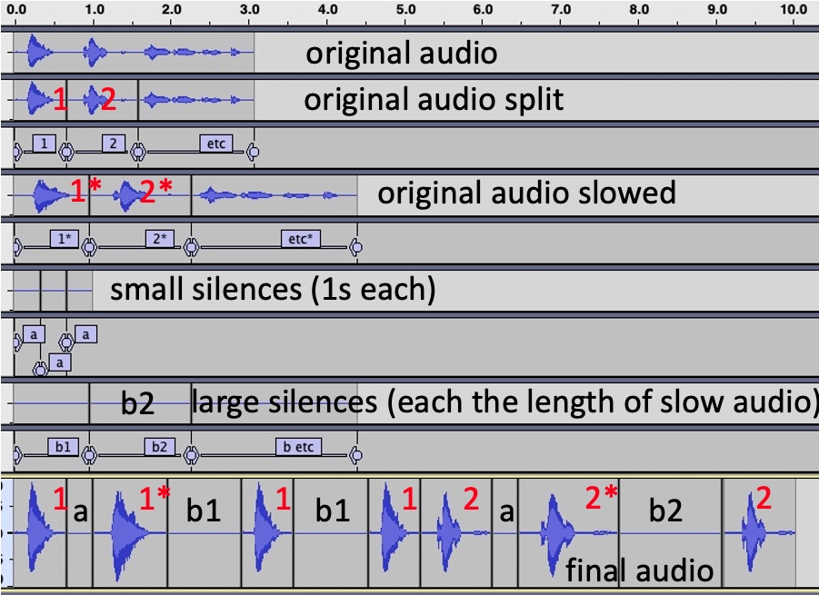

Thanks again, Steve. I wanted to try your alternative, but couldn’t see how. I think it’s because I didn’t explain well enough.
original audio: 1-2-3-…
final audio: 1-a-1*-b1-1-b1-1-2-a-2*-b2-2-b2-2-3-
notice that clip 1 is repeated 3 times at normal speed (1) and one time at slow speed (1*), same for 2, etc…
also notice that while the short silence (a) is always the same, the longer silences have lengths corresponding to the preceding slow sound (b1 is as long as 1*, b2 is as long as 2*,…). This is important because the long silences are gaps where the listeners is supposed to repeat the preceding clip, which can vary in length.
I made an audacity project to apply your method, which is attached in compressed form. Here’s is an image of it.
The key point here, is that my audio will have many clips (~hundred) and so manipulating manually makes no sense.
-Tony
rearrange.zip (1.48 MB)

I see my use of the term “manually” was misleading. What I meant was to manipulate each clip along the final track, using for example, the shift tool so that the clips position at the right place, or copying and pasting a clip from one track to another. No doubt you have another way in mind to do this, but I did those manipulations since I don’t know another way (except by method described originally).
If you or others could explain how to produce the final track in my simple example (having only 2 clips) then maybe I could apply it to a case having ~hundred clips.
Thanks
