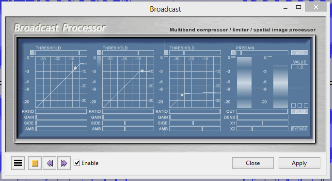

If you’re aiming for music-video/radio-broadcast loudness, try ToneBoosters broadcast plugin,
Looks complicated but it has presets …
