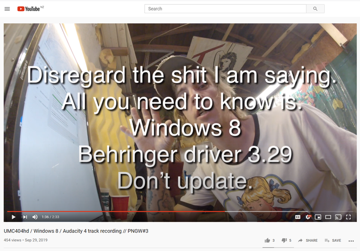

https://www.youtube.com/watch?v=QzwGCgotAoM has this:
(I wouldn’t bother watching the video!)
