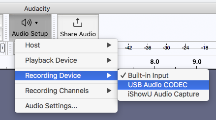

Getting Audacity to record something is not for the easily frightened.
Quit Audacity.
Plug in your 202. Wait. Start Audacity. It doesn’t work the other way around.
Audio Setup > Recording Device > USB Audio Codec
Screen Shot 2023-09-19 at 10.46.54 AM

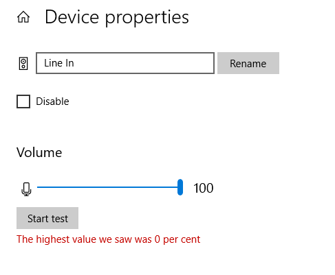

Just finished doing this:
The 202 natural pathway is to monitor the computer playback. If you switch Monitor to ON, it will let you hear both directions. Make sure the little thumb volume control is up.
There’s another note, too. With Audacity off, you should be able to drill down to Windows Device Manager, or whatever it’s called now (said the Mac person). Windows has its own bouncing sound meter in those graphics and controls.
And finally, I would probably not have installed the Behringer software. It’s not needed in this simple application and may now be making things more complicated.
Already done. Output direction works, input doesn’t.
