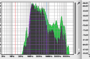

The plot on the left is the original recording and the one one the right is the rerecording. I’m going to look into the EQ matching plugin because that sounds like exactly what I need. If not I’ll try to try your second option. Thank you so much!

If you want the re-recording to sound more like the original, boost everything above 1000Hz by 6dB.
Is there a fast way to do that, or do I have to manually adjust everything in the filter curve EQ? This is my first time working with Audacity, so everything I do has a learning curve.
If you only have Audacity native tools, then there is no one-step fast way of matching the EQ.
Several cycles of trial and error : adjusting the EQ, then comparing the spectrums, wash rinse repeat.
