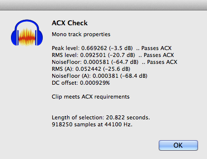

Here is a more performance oriented sample. The only technical thing we changed was to raise the PAV input level to 135%, or approx. +7.4dB. Other than that, the file is raw and unaltered. Running ACX Check shows that Peak and Noise Floor pass but RMS still fails. How can we fix that? Would this sample be able to be finished with Audiobook Mastering effects?

Aaaaaand. We’re done. Starting with your post, I applied normal Audiobook Mastering and then added noise reduction at 866 (slightly stiffer than 666). This is expected because the SM57 has “gentle” volume and needs the X2U to work a little harder. Nobody but us will know.
The whole correction suite including Noise Reduction took less than a minute.

I do like your mods a lot, and I also feel that the DeEsser does add to the mix. It makes a difference and gives a cleaner track. Thanks for all those links, I’d seen some but didn’t know where to get the DeEsser. There is still a lot to experiment with mastering and noise reduction in the future, but your settings have gotten us a much cleaner take that passes ACX comfortably – thanks so much for all the guidance.
So I just went to test the effects series that you used and applied them in sequence as you recommended to my copy of that raw file. I got the exact results you did on the ACX Check except the Noise Floor was 0.1dB lower. All other readings were just the same. So that sequence replicates for me here too, and as you said, it really does not take much time at all. I’m sure other files and other vocal requirements will call for different settings, and that’s when I’ll learn just what effects really do on their own. But the synergy of the ones you chose really makes a difference. Hey, there’s hope for this SM57 yet, I was beginning to wonder….

We made another test run of a 1-minute clip, and applied your full 3-step Audiobook Mastering, 8-6-6 NR, and DeEsser to it and have submitted it to ACX through their survey form in the thread you linked to.

We finally heard back from one of the ACX analysts, and – we passed! I was concerned that a one minute clip might have been too short, but the reviewer said that the file met all requirements. He also sent along a zipped attachment of good & bad samples, as well as ideal examples from each stage in the production process. They are WAV files to import into Audacity to see on the meters and hear what they are after. It’s a set of clips that will be a useful learning tool.
