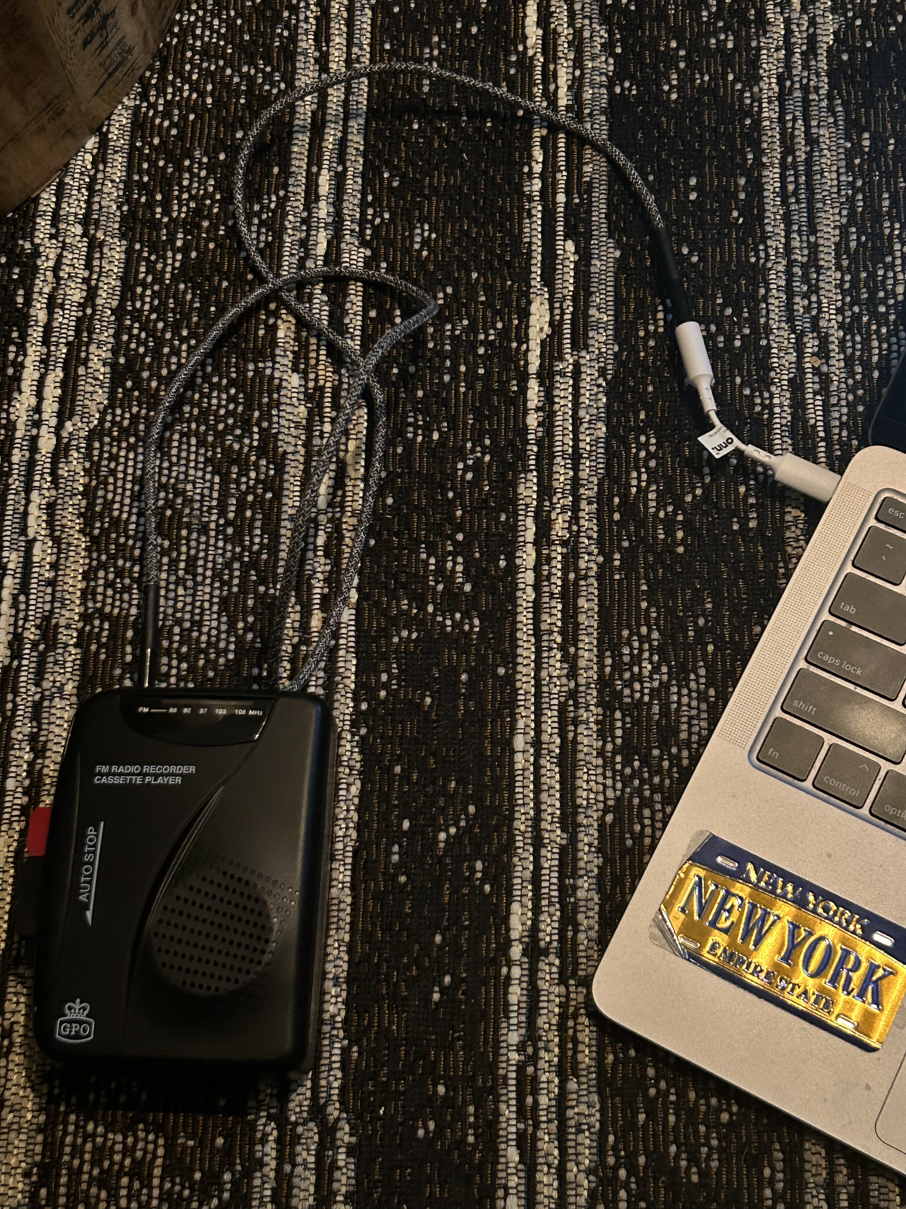

Hello. I need some help fixing this horrible audio quality issue. When I record from my AUX to USB, the audio quality is bad. Even when I plug the aux cable directly into my Mac computer, the issue isn’t fixed.

What exactly do you mean by “AUX to USB”? How are you plugging an “aux cable” directly into a Mac? What kind of radio are you recording from?
Please tell us the makes and models of the equipment you are using, including the Mac.
I’m using an ONN Aux to USB converter. The radio I’m using as a Sangean HDR-14, but I tried it with a different GPO radio and the audio still sucked. The Mac I’m using is a MacBook Air.

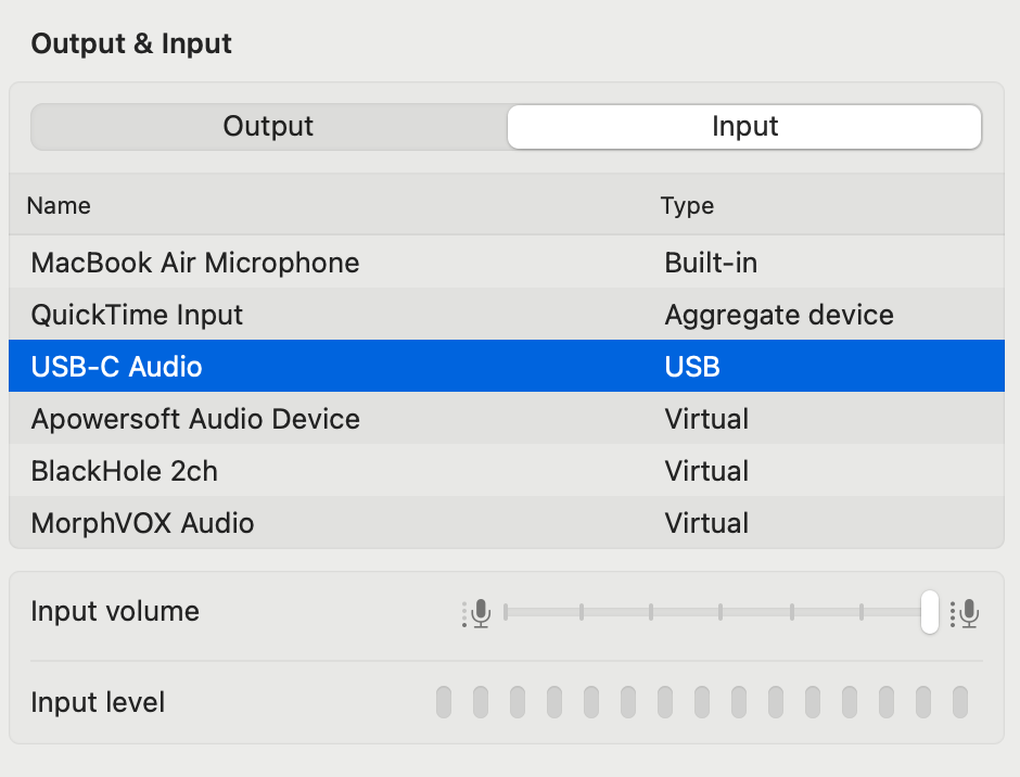

Go to Apple (menu) > Settings > Sound then the Input tab. What options do you see there when the ONN device is plugged in?
How are you plugging the “aux cable” directly into the Mac?
This is how I have it plugged in. The device that I’m using is this: Robot or human?
This is what I see when I plug the adapter: https://northmountainfilms.neocities.org/Discord%20for%20files%20I%20can’t%20upload%20/Screenshot%202024-11-07%20at%206.25.25 PM.png
The “specs” for that device aren’t clear but it probably has connections for a headset with a microphone and headphones.
A line-level or headphone signal is about 100 times stronger than a microphone signal so you won’t get good quality.
You need a “USB audio interface” with line-level inputs. The Behringer UCA202 is popular and relatively inexpensive. (It has RCA connectors so you’d need a different adapter cable). There are lots of higher-end audio interfaces with switchable pro-microphone and line inputs (they don’t work with “computer mics”).
You can find some cheaper too, but don’t get a regular “USB soundcard” because they are like line inputs with only mic-in and headphone out.

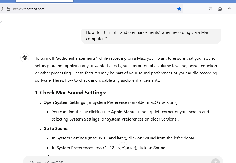

As I don’t speak Mac, I asked ChatGPT …
The Mac Sound Settings do not have any enhancements or processing built in. I’m told that Skype or other software may install something.
