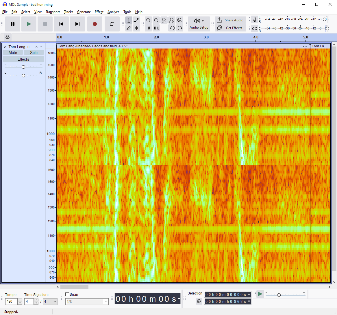

Applying a lot of graphic EQ at 1.0kHz and 1.25kHz, as shown below, greatly reduces the audibility of the noise. This is equivalent to a deep notch filter. Of course, the notch filters suggested by @Trebor are a much better approach.
Zooming in on the frequency axis of the spectrogram, we can get a better idea of the three noise-making frequencies in question:

“select all” option is to select the entire duration of the audio, not just part of it. IMO you need 3 notches
notches2
BTW if the pitch of the hum changes over the 45 minutes the notches will become less effective at times, (Audacity notches do not track the hum frequency).

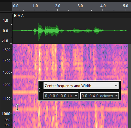

Can you make an animation of how to run the Plot Spectrum tool to find the exact frequencies of those peaks for the Notch filter?
It’s a lot easier using the spectrogram display and Audacity’s spectral editing tools
hum-spec-plot
The spectral editing tool works really well. @Trebor, thank you for the detailed description of how to use it. I performed a frequency analysis of the lead-in waveform after three notch filters were applied. Their effect is clearly visible, with the amplitudes of the three noise peaks being significantly reduced.
