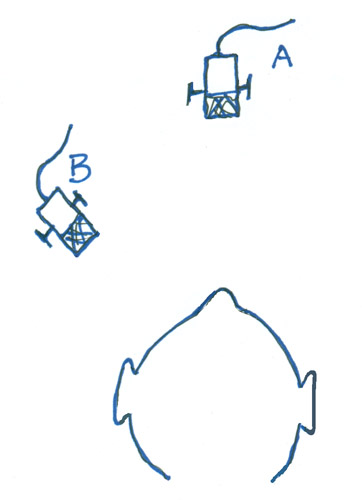

You can get closer and louder if you use oblique microphone placement (B position).
Closer and louder may be all you need. When you finish reading and before you apply any corrections, your Audacity blue waves tips should be at about the 50% mark. Your posted file should be what the waves look like when you stop reading.
