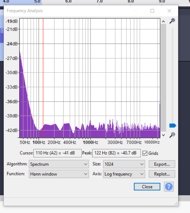

Ok, for some reason when I tried to use that macro it did absolutely nothing… but I recorded a five second clip without the mic plugged in to my interface, then just applied loudness normalization (-18.0dB) and I got CRAZY static. It wasn’t just like a hiss it was overwhelming… like an old fashioed TV that wasn’t tuned into a channel. I looked at the frequency analysis and I got this back:
As the mic wasn’t even plugged in but I got this over the top interference is it safe to say that it’s actuallyt an issue with my interface?
That’s pretty BAD!

Other than high-pass filtering (which should have reduced that low-frequency noise) ** it mostly just adjusts the levels** and it’s sort-of a way of getting the signal-to-noise ratio.
The low-frequency noise looks a lot like room noise but you can’t get that with the mic unplugged! Unless… You are accidently using your laptop’s built-in mic and that would explain EVERYGHING.
