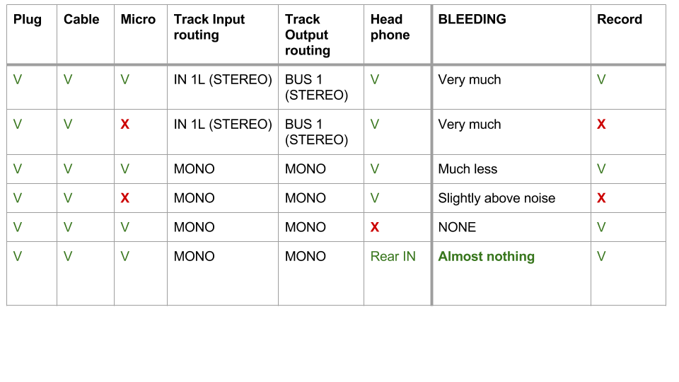

(the plot thickens). I want to add some more information, not because I think there will be a solution for me (using a 15 year old XP probably just cannot be fixed), but in case someone else has similar problems and maybe this might help (or maybe not).
Yesterday I found out that when I play anything else (a bit like, - as someone earlier mentioned earlier - “recording YouTube”) while recording, this does NOT leak into the newly recorded track. This is the point where I really throw my hands up in the air and just give up.
To clarify: I am using this website to make a drumpattern: http://webaudiodemos.appspot.com/MIDIDrums/index.html Now, if I play the resulting drum-pattern on that webpage (on Chrome but I don’t see how that matters) and then open either Audacity or CuBase and record a guitar track played live in front of the mic, the drum pattern does NOT leak onto the guitar track.
To summarise:
Case 1: Play an existing “track-1” on audacity and record a guitar on “track-2”. Result: sound from “track-1” leaks onto “track-2”.
Case 2: The same with CuBase. Result: the same
Case 3: Play some pattern on the “Webaudiodemos” website and record a guitar on either Audacity or CuBase. Result: sound from website does NOT leak onto “guitar-track”. Of course, the problem here is that now I don’t have the drum track inside (on a seperate track) in either Audacity or CuBase.
By the way, I did find the “Stereo Mix” setting on my PC (“Mezclador Stereo” in “propiedades audio”->Audio->Grabar->Advanced) but it cannot be switched off (I can only put the volume bar to zero, which I did but which does not make any difference whatsoever).
It’s a bit like a John Dickson Carr locked-room mystery where nothing seems to make any sense.

Also have you looked in the Realtek Control panel as was suggested?
Thank you all for your help. I didn’t look at this forum for a while but I managed to solve it, and basically my solution confirms the post from Gale Andrews.
In the attachment, I have put some details of my investigations.
I think the solution was a number of things, but mainly, as Gale suggested: one (or more) of the I/O ports must be wrongly wired.
Now, I have the microphone in one of the front input ports (pink) and the headphone in one of the back input ports (I don’t remember the colour, I tried them one by one).
Having both plugged in front OR both in back would give rise to bleeding again, but having one in front and the other back solves it…
(Having the recording in MONO instead of stereo also slightly helped but was not the main solution). Even without connecting the actual microphone (but still having its cable connected to the port) I would have bleeding as soon as this cable and the headphone cable would be in ports near to each other.
I am posting this in case it might be helpful for other people with the same problem (which ocurred both with Audacity as with Cubase, so it’s not a problem of settings of those programs). Operating system: Windows XP (…yes, I know…) Soundcard: RealTek.
As I said before, there was no way I could configure the RealTek card itself (no option like “Get Waht You Hear” or “Stereo Mix”).
I am guessing that as soon as I’d buy a new PC with a modern soundcard, the problem would not appear (I hope), but for the moment I am glad I can still work with my dinosaur PC.
