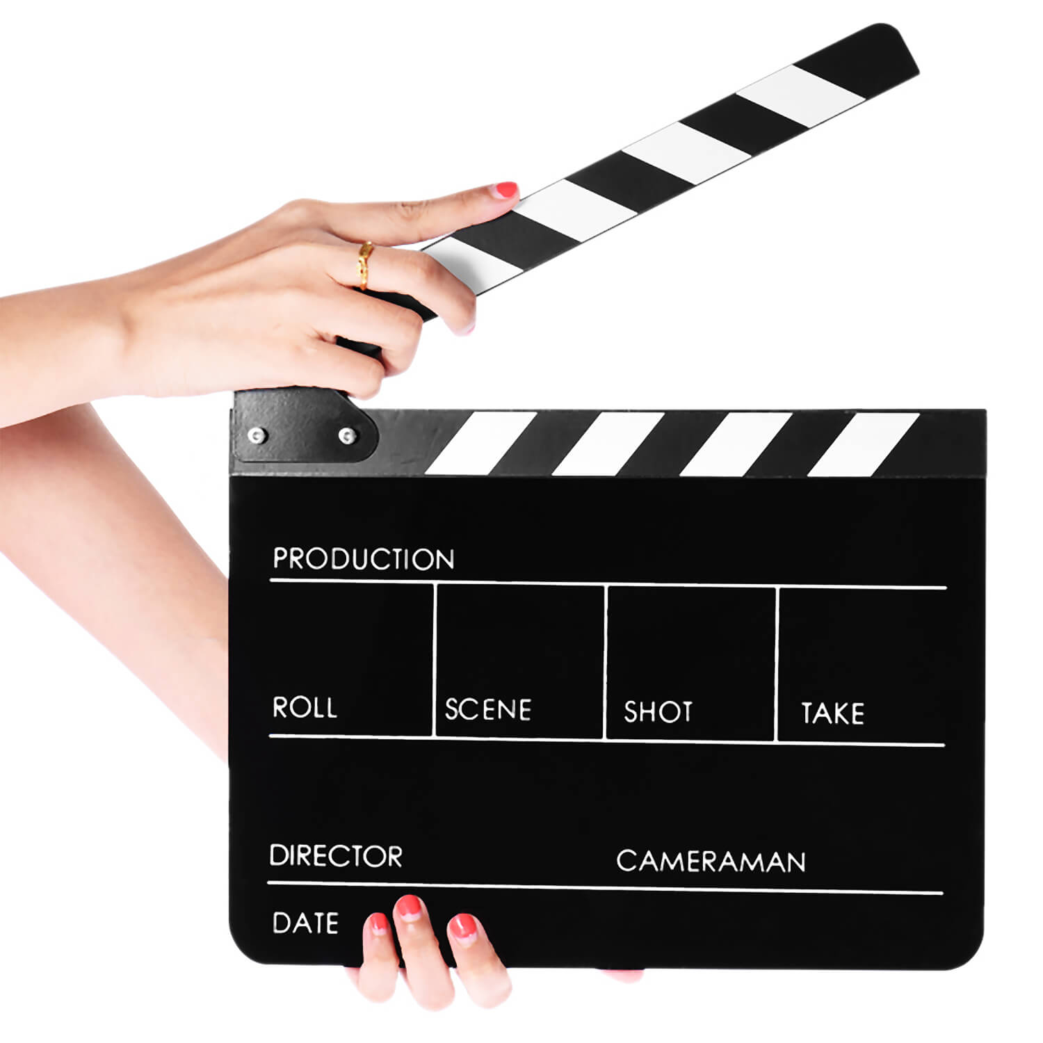

The traditional way is to record a clapper board at the start and end of the recording. This provides two clear marks for easier aligning.
Clapping your hands a couple of times is nearly as good.
If the mark at the end does not line up exactly when the start is lined up, then the recorders were running at slightly different speeds. In this case, use Audacity’s “Change Speed” effect to match tracks to your “master” recording.
I’m familiar with clapper boards, but it still requires manually aligning the tracks with the first clap. I’m looking for a way for Audacity to sense the clap on each track and align the tracks automatically.
