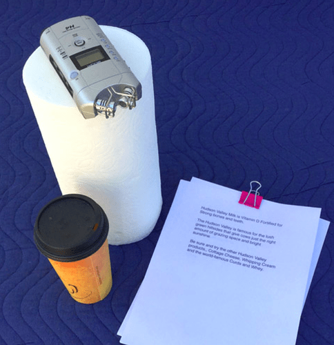

Thanks again. My originals came through a good mic and preamp, but reside in the computer. They were done in a studio, and are below the -60 noise ceiling, so I’ll stick with the computer files, at least for this book. Never occurred to me to use the Zoom (I have an H2). And love that creative GOBO. Does the coffee cup figure in?
Good Computer Hygiene tells us to be able to point to two separate places that contain your valuable work. So the computer hard drive and a thumb drive count. Separate hard drive is OK. Cloud storage counts. Two partitions on one hard drive does not count.
That pointing metaphor is intentional. Point to the computer and point to the USB Thumb Drive on the credenza.
This is where I do the three-minute soft shoe about the acoustical resonance function of a half-full 17 Oz (502ml) cardboard coffee cup. It’s there as a pictorial size reference.
I can do a real three-minute soft shoe about the dark blue furniture moving blanket on the desk and the acoustical properties of a roll of paper towels. That’s far from the worst studio setup in the world, especially given you will be missing the noisy computer fans, unintentional voice processing and the electrical interference that a USB microphone can have. I was able to announce with that and produce a stable, ACX-Compliant voice clip with almost no effort.
