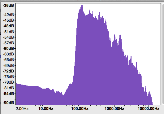

This is the text version of the equalization effect. I think the name was the only thing that ever changed. It was designed as LF Rolloff… and got changed into Low Rolloff… for its debut.
Here’s a thing I wrote on the sister posting.
https://forum.audacityteam.org/t/help-step-by-step-acx-requirements/54064/14
That’s the current curve. At a length of 4855, that green line is what it’s really doing.
