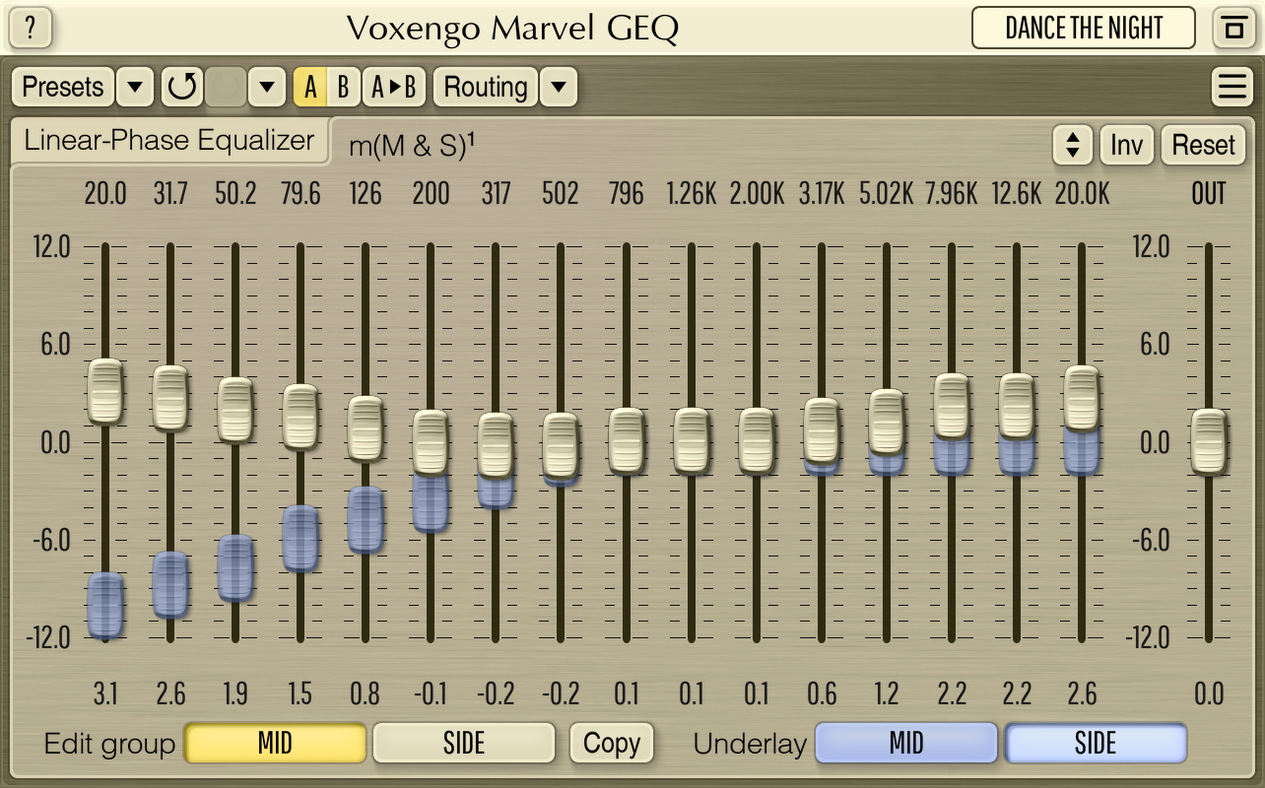

There are free equalizer plugins which work in Audacity in Windows,
which behave like a real hardware equalizer that you can adjust in real-time when the audio is playing …
https://www.voxengo.com/product/marvelgeq/
https://www.tokyodawn.net/tdr-nova/ *
https://www.gvst.co.uk/gmulti.htm *
( * can equalize & de-ess at the same time).

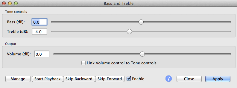

Then Effect > Bass and Treble > OK.
