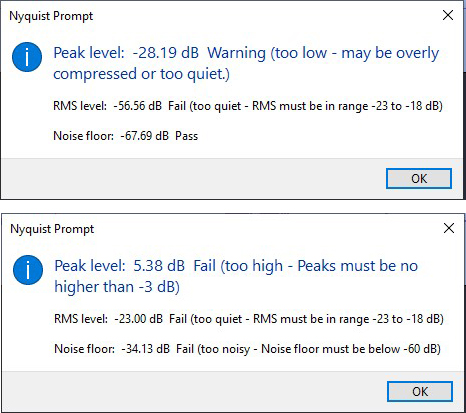

So I got the ACX Check working. (Still working on the Macro) The first photo shows the audio before Loudness Normal and the second photo shows after Loudness. My gain is set to about the 2:00 position, but it doesnt seem to matter how I adjust it.
