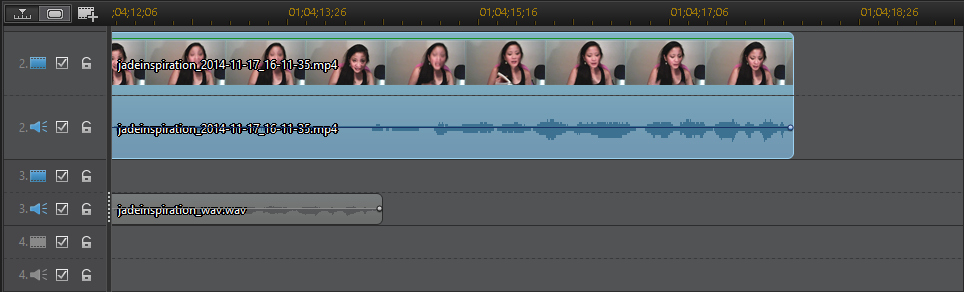

So, I tried exporting as a wav as suggested and now I’m more confused.
As an experiment, I dragged the original MP4 into audacity and export the tracks as mp3 and then as wav. I then brought the new files back in to compare wave forms and found the mp3 didn’t match, as expected, but the wav did, as hoped.
But then… I imported the MP4 and exported wav, which matched up in Audacity, into my video editor (Cyberlink PowerDirector) and they didn’t match up for length again. Since all the original files match up in PD, and the wav and mp4 match up in Audacity, I assume Audacity must be doing something slightly wacky with the mp4. Is there another conclusion I can draw?
Attached are the visual comparisons of the original mp4 and wav side by side in both PD (3.2 sec diff) and Audacity (no diff).
Any thoughts?
Or your video editor is - either way, MP4 is a pretty wacky format.
Rather than importing the MP4 into Audacity, try exporting the audio from your video editor in WAV format, and import that WAV file into Audacity.
Exporting the audio from the video editor and then using Audacity to split left and right seems to work fine.
I have a process now. Thanks, Steve!
I actually think it’s something with the MP4 file. I’ve sometimes had trouble with the audio & video going out-of-sync with editing MP4 and (other highly-compressed formats) with my video editor.
Sometimes, I’ve been able to “fix it” by converting the file to MPEG-2 (usually with uncompressed LPCM audio) before editing. Unfortunately, this means the video is going through an additional lossy compression step.
(MP3 compression will add a few milliseconds of silence to the beginning of the file.)
