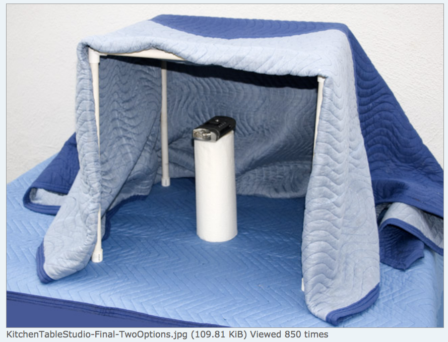

multiple heavy moving blankets to deaden the sound.
I’m a great fan of furniture moving blankets.
Please note in both of those arrangements, there’s a double pad on the floor or desk.
The little desk cave came from this posting.

My little cave looks a LOT like the second photo you posted, except its a bit wider and deeper to give me space as well as have the monitor and keyboard. I dont have a blanket on the desktop, though, but I do have a foam mat that goes the length of the desk to make it more comfortable to lean on. Is that sufficient?
And that’s based on an actual commercial product.
