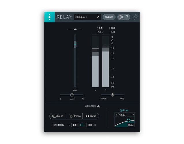

I always normalize my audio at -3 dB however I have carried out a test in a plugin called Relay to make this measurement however, even though the audio is at this normalization of -3dB this plugin like the others for example at certain times of the audio there are quick peaks exceeding 0 dB. Is this normal for a spectrum analyzer or even this plugin I mentioned above?:

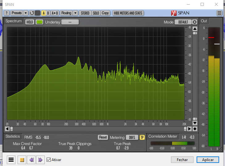

Regular normalization (peak normalization) is pretty-much foolproof. If you normalize to -3dB in Audacity the highest actual peak(s) will be at -3dB.
Some analysis software looks for “inter-sample peaks” and that can show higher than the actual digital data. There is no actual inter-sample data in the digital domain, there are only samples. The inter-sample peaks are an estimation of the reconstructed continuous analog output from the DAC (where there are no samples).

I also used an analyzer called SPAN, whose image is attached. The same thing happens, even though the audio is -3 dB normalized in Audacity, at times the signal is saturated by observing the led on the ruler.
So by your explanations this would be normal, or would I have to decrease the output gain to avoid this saturation even just in a few moments?

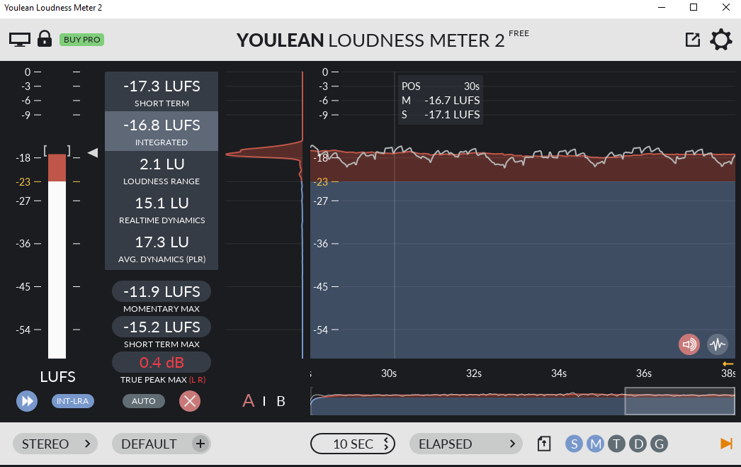

But I downloaded the software and installed it, it is working normally as per the attached image.

The example you’ve shown has “integrated loudness” of -16.8 LUFS.
Different platforms have different loudness standards,
( e.g. on YouTube the maximum loudness is -14LUFS).
Your example has a “true-peak maximum” of +0.4dB, (i.e. clipping a little bit, probably inter-sample).
To cure your clipping use Audacity’s (soft) limiter …
